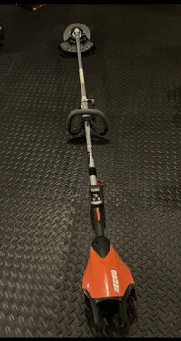

I bought the brush cutter attachment for my echo battery dpas2600 powerhead and it works great for small pear, honeysuckle, barberry, multiflora rose and grasses. I dig up and uproot everything I can, but if it’s too big for that I zap it with this and stump treat. Basically just a circular saw on a stick. It’s nice to not have to be on my knees with a chainsaw as much.
  • Like
Reactions: ATH
Those are great for the right sized stuff! The biggest challenge I've found is treating after cutting. Do you have a good system for that?
