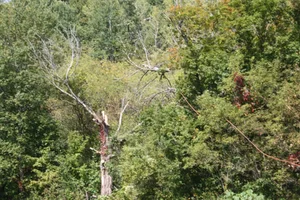

Sorry Tom, That is my 3/4" Samson stable braid. Please excuse my ignorance but is Posion Ivy not a climbing rope?
I was taught long ago that you don't climb on a bull line and you don't pull with a climbing rope. Am I wrong?
I would love to hear your and everyones input on this!

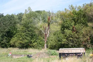

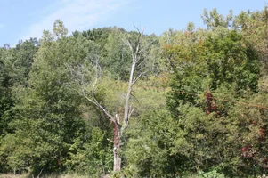

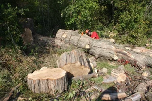

, didn't climb the tree though, dead and standing for way too long!! Tossed a line in and "gently" applied tension with the loader until it exploded, then dropped the trunk.
Great pics Woodsboy!
You weren't working alone were yu?
Thanks for sharing.

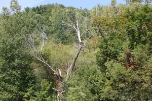

John... Yep, you string a horizontal rope between two sound trees and hang a floating anchor from it. This is a pic from one I setup with Stable Braid a while back...
It makes scary trees a lot more comfortable. You need a way to get away from your lanyard if the primary structure fails... but that's another discussion. I only put in the lanyard when I needed it for positioning. With Stable Braid I had to tension the whole system with a 5:1. With the HTP I just pulled it hand tight and it was good.
