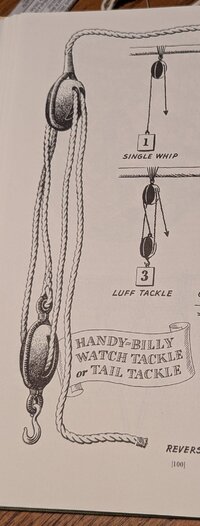

We can have compound levers at truck stop scale of a series of levers pushing each other to compound or dilute further. This can be done extensively inside transmission for rigid radial gears. But also in our "rolling levers" of flexible ropes. Meet the Burtons (2005 older style pic):
This can be an exercise to see, but once catch the form can trace it then more confidently into the simplers.
