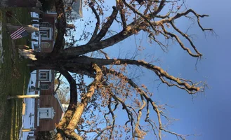

That is our plan. It may be that we can only use it on the main bole which is the big pick. The distance for the crane is 70' from the center of the crane located on the road to the far side of the trunk. Currently we have a 150 ton crane spec'd but I'm not sure if that will give us the safety margin I'd like.
That trunk is 78" DBH or 20'4" circumference.
Holy crap! That tree is 600 years old. It was an old oak when Columbus came over!
You are going to have to surgically lift every scrap of concrete and cabling out of there to keep from hitting the civil war tombstones, and bombing the chunks into the spot where George Washington and Lafayette had a picnic, @treehumper you sir are a brave soul and I can't wait to see the documentary, be sure to post updates and start a thread, what a project!
