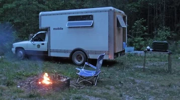

Right now, this is my fun mobile. The other one is a plain ol' '98 GMC Safari Man-ee van ;) The ToyBox is going to become a camper.

That's good truck/camper. Do you have a bed in there? Any sink and table stuff?
