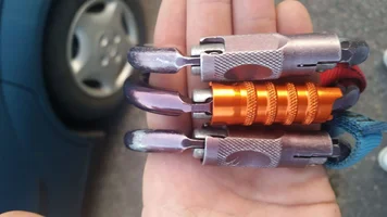

I have also some Ball Lock Am'D and William and trust them too. These biners just came in my mind as the thread came to boiling and plastic. Whereas I suppose Greg meant another manufacturer.
I have made a photo from a open gate of a 2014 William (Am'D 2013 looks the same). It is difficult to say how much plastic is really inside but it seems to be more than the tip.

That is a great macro photograph, Bernd! Thanks for posting it!

P.S. Since it seems to me that it is the plastic button being pushed out that keeps the gate from being rolled open, it would seem prudent to me to avoid any methods of cleaning the ball lock Petzl biners that might cause a weakening of that plastic. In other words, no high heat or caustic chemicals, in my humble opinion.

I have had the same issue. Also with ALL the ball lockers I've encountered.. There doesn't seem to be much gate meat over the nose. That worries me. The triacts rotate the full way, and I love them.. But the ball lockers just look.. Flimsy to me.

Great photograph to demonstrate your point, jmaher. I see what you mean about the lack of "meat" over the nose. All I can say about my own personal experience with both types of biners is that my twist-lock opened up on me once by accident, and so far my button-lock biners never have. I don't have nearly as much time in the saddle as some folks, though.
