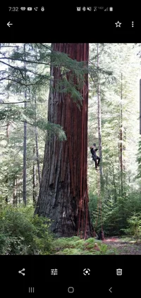

Here's one I climbed a few years ago. Mind you I am no way an "experienced Redwood climber", but I have climbed a few big ones. To set a line in this tree I used a very simple method my friend Jerry Beranek taught me (who actually took this photo). Its using a bigshot and changing the weight and line. We used monofilament fishing line and a 4 oz. Surf weight. With that setup I could hit 200' each time.
I would also stress that at that height you cannot tell if the branches are going out or down, so you simply trust them. We also employed the many branch approach paired with as much of a wrap around the tree to a base anchor.
Last I would also leave the possibility of dual ascent lines, dual anchors and in opposing directions. Hope this makes sense.

That is a poster worthy photo Mark, and having Mr Beranek take the photo only adds to its awesomeness!! Very rarely is hitting height the problem in Reds and like yourself I can consistently hit marks over 200 ft with the APTA. The problem is consistently being able to get your line over a limb/limbs strong enough to support a climber, and getting your line over a limb/limbs that are not growing in a downward direction. Plus as you mentioned you need to be able to actually see that your line is in fact over something trustworthy, and see that your line is relatively tight to the trunk (binocs & wraps on the trunk are essential). I would also add that doing all this is generally more difficult on 2nd-3rd growth Reds due to their limb strength and structure, and 2nd-3rd growth are generally the type of Reds a working Redwood climber will see in his/her day to day tree life.. What your left with is a recipe for serious safety issues, or massive productivity problems if one is striving to go completely spurless as a working treeman in Redwood country......Either your going to spend the better part of your days trying to get a trustworthy tie in set, or you can "simply trust them" (been there, done that), or your can throw some spurs on and go get some work done...This is why spurs still reign supreme in the life of most working Redwood climbers....
