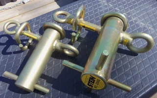

I couldn't decide which of these I would use the most, so I bought both. Pic taken when they were new. They're holding up well, and I'm glad I got them both. Strong as hell, but heavy. That's a good thing, though... they probably won't break. Yellow zinc plating is still good after a year. The big Stein cranker looks like it would hold up to anything I'm likely to use it for, and it's what? About $1200 with the winch? Good price, something I can probably afford. I don't bomb half the tree down in one shot, so I'm thinking it would be up to the job. The Hobbs and GRCS are just too much money for a po' boy from the other side of the tracks.

I like the idea of the big bollard, so maybe $650 for the RCW-3001 and then buy the winch later? I think it ends up being the same price whether you buy it all at once or separately.

I had a porty made from ss schedule 80 pipe. Looks to be the same size as your stein. I know what you mean by heavy. That one doesn't come out as much any more.
