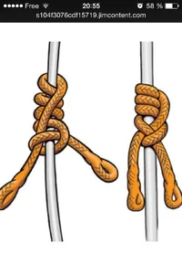

Here is a video that yoyoman did on friction hitches. He shows different hitches, ways to pair them with the climbing line, and that not all cords/hitches/lines are compatible.

This makes sense. It's just the stiff ocean imo. The same thing happened to me until it was broken in. I think a 4 wrap schwabisch will help.

Try a "Knut Froppe" hitch or something like that. Stays tighter on the line for longer, but as with any friction hitch, it'll work loose if you don't keep an eye on it.
You might try a schwabisch hitch until it is broken in. I started with new tachyon and ocean - both were stiff. Schwabisch grabbed best at first. Once both the rope and hitch were broken in, I switched to a distel. I don't use ocean anymore because it takes so long to break in, then once it does break in, it doesn't like to be tied in other configurations.

The suggestion to use a Schwabisch hitch was the solution for me. It doesn't advance as great as the VT or distel but there is no tending required while climbing and descents are smooth enough. Thanks for the info NorCalBrock.
