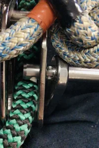

My Notch V3 quickie fits and the edges slide right over the screws when it needs to. It’s not super easy getting the quickie back off though. Gotta use the body of the HH to release the slic pin, you’ll see what I mean if you try it. Played with it a little and I much prefer the steel oval biner.
Also, mine has screws, not rivets.
@rustykfd did a little mod on his, he took out the 4 lower screws, countersunk the holes a teensy bit and put machine screws in it that seat flush with the body so he could use a bow shackle. It has to be easier than fighting the slick pin.
Pic is his from when he sold it, maybe he’ll see this and comment how it worked for him.
Using the HH2, plastic holster and SingTree's cast Quickie... Nice and more compact than either the HHx or the HH2 with the oval carabiner... Woo hoo! Just not as fast a setup and removal as it is with the oval carabiner, or other multicenders. Moreover, the slic pin acts like a pulley and if you don't use the plastic holster it blows the whole deal.
Using the HH2, plastic holster and a Sherrill Quickie... Nice and more compact than either the HHx or the HH2 with the oval carabiner... Woo hoo! Just not as fast a setup and removal as it is with the oval carabiner, or other multicenders. Moreover, the slic pin acts like a pulley and if you don't use the plastic holster it blows the whole deal.

According to my calculation, I measured the pin's diameter at 1 centimeter, or 0.393701 inches. This includes the pin's beveled edge. The other specs below are from the seller's web page (https://www.sherrilltree.com/cast-singing-tree-quickie).
I see now that this (Singing Tree Cast) Quickie is different than the Notch Quickie V3, but the advertised specs are almost identical except for the Notch's weaker Minor axis. The two pin's diameters are different and I don't have both to compare, but they are both 2.5" long.
Major Axis: 30kN,
Minor Axis: 15kN (Notch Quickie V3 13kN)
Length: 2.25"
Width (no slic pin): 1.5"
New Slic Pin Length: 2.5"
Sideplate Width: .875

Cool thanks! Richard ( climbing innovations) did a video where he measures his slick pin diameter as 9.xxx mm. So that tells me his quickie will fit the slot in the least. I could just measure the slot in my hh2, but my calipers are at my shop and I won't be there till monday. I wonder where Richard gets his quickies? Could they be the same? Even if they are, I'd buy them from Richard before Sherrilstuff.
Climbing innovation quickie measurments from Richards video:
Slick pin diameter : 9.9 mm
Slick pin length from shoulder to first tab : 45 mm
Shackle overall length : 75mm
Shackle overall width : 38 mm
Shackle internal width not given, but it fits the hhx body pretty close and the body measures 25 mm wide. I am guessing the shackle to be at least 26 mm internal width but likely 27 or more.
So the CI shackle is considerably longer than the sherrill and double the length of the singing tree. For this application, I think that is good.
When I get back to my shop, I can measure the outside width of the hh2 and hopefully find out if the CI quickie will fit without installing counter sunk flat top screws.
