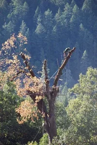

An 8' dbh oak tree with a treehouse at 50' turned brown this summer.
This witness tree from the 1855 survey marker was topped out at this weekend at Out 'N About resort in Takilma, Oregon.

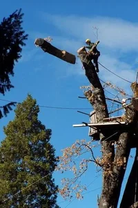

Histree has some trunk strength issues with a large column of decay. Steel guy lines lash down this tree of King Kong stature. Burgeoning striations of wood grain texture display a map of internal trunk stresses.

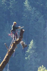

The limbs over the cables were redirected by hand. Cut small and push them away from the wire as they fall.

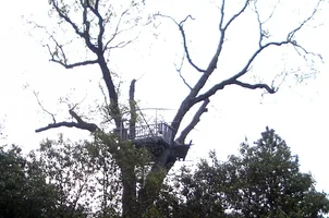

Here's a photo from early May of this year, 2006. Jonathon Fairoaks & I pruned the tree at the World Treehouse Conference in October of 2003.

A little more on the HisTree of this tree:
MIchael Garnier was drawn to the land because of this tree.
Although the horses were certaily a problem the real culprit was the inevitable decline of this amazing tree coupled with Garnier's thinking he could help it out and so...built a garden around the base of the tree (inside the corral fence).
He watered and fertilized all summer and that is not what this tree had experienced in the past.
The platform was Garniers refuge from the law when they were tring to bust him for his tree houses not meeting codes...his battle once won has paved the way for tree housers recent efforts to build their dreams within the local laws.
When I first saw it 10 years ago the half of the tree still left measured 110" x 88" DBH. The shell of the lower trunk was horshoe shaped from the failure of the seconf trunk with less that 6" sound wood.
I got Michael to buy an air spade and while trying to fix the soil a bit did a root crown exam and found all of the original structural roots turned to mush. A web of adventitious roots was all that was left!
I used to climb the tree via the hand holds that were nailed to the long dead section of the main trunk...a cool stem move allowed entry to the platform through a trap door (about a 5.7 climb).
I decided that, for me, the tree was unsafe to climb in four years ago. That winter Garnier called me to tell me the tree had shifted. They leave the climbing ropes up year round and they made a great plumb line that showed the movement. This is when the zip wire to the rest of the resort was changed to a breakaway link and the ground cables added. Michael and I also tried to graft new branches onto the lower trunk and had planted a couple small trees nearby thinking to graft them into the old trunk!
Out N About used the tree until this summer when it died...Michael had actually leveled out the platform as the tourists were somewhat disconcerted by the tilted surface up there! All the workers there remember times when I've arrived on site and immedialtely been yelling at them to get the people off the darn platform as soon as they arrive...one time there were nine people on the platform and two people ascending...one of whom was a big fat guy! I swear I could see the tree flexing and hear it groaning.
For the last three years there have been spectacular displays of fungi fruiting bodies around the base of the tree. One of the main buttresses had developed a horizontal crack... I will post a picture or two when I can.
So....the current management plan is to try and keep the dead tree standing for as long as possible....thatkfully they have stopped taking people up into the tree...sigh of relief form ScottDB!
PS We are trying to salvage some of the wood that MIke and his Japanese helper Taka cut off. I think the tree was 500-800 years old!
