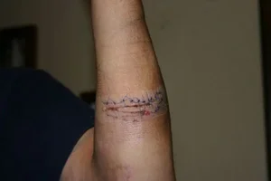

I was limbing a Maple tree on the ground. I had picked it with the crane 1 piece. I was hurrying and didnt limb it as I set it down so there was a lot of pressure on a couple of limbs. The saw was a Husky 346XP. I dont think a Stihl would have had the power to cut thru all the scar tissue already on that arm.
No, I was at waist level with it. If you can imagine looking from the but of the tree toward the top I was on the right side of the trunk. So the saw was infront of me but at an angle to the right. Not a very good position(obviously).I was reaching out a little also.

Wow! That's a cut!

Oregon State extension has a article called Felling & Bucking Techniques for Woodland Owners. Page 11 is relevant to this conversation a little. It is preferred to stand on the left side of the tree/spar when bucking & limbing. Click Here.
Mark, I don't know if this would have prevented your accident by standing in the left side of the spar or not. What do you think?
Also, I understand it is not always practical to stand on the left side, but it is preferred. Since I am aware of it I make the effort to limb & buck the way described in the article. Besides, it is highly efficient in the long run to minimize steps.
If I was on the other side of the treemy left arm would not have been in the path of the saw, So that is correct.
Dang. A simple move to the left side. But, I understand our working conditions don't always permit that. Keep a good diet and your body will heal fast.

That was a nasty looking cut Mark! Thanks for sharing it, things like this stick in peoples mids and might keep someone else from getting cut.
No tendon damage. Possibly some sensory nerve damage but Nothing major. It is getting better daily. Thanks for the feedback.
