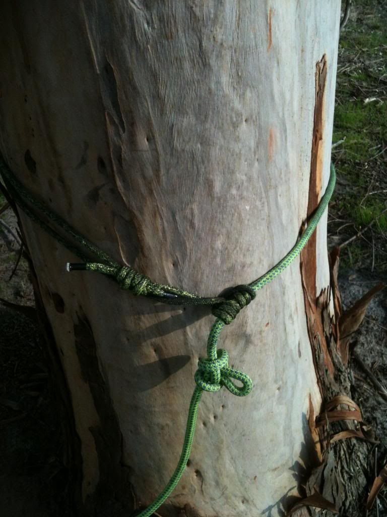

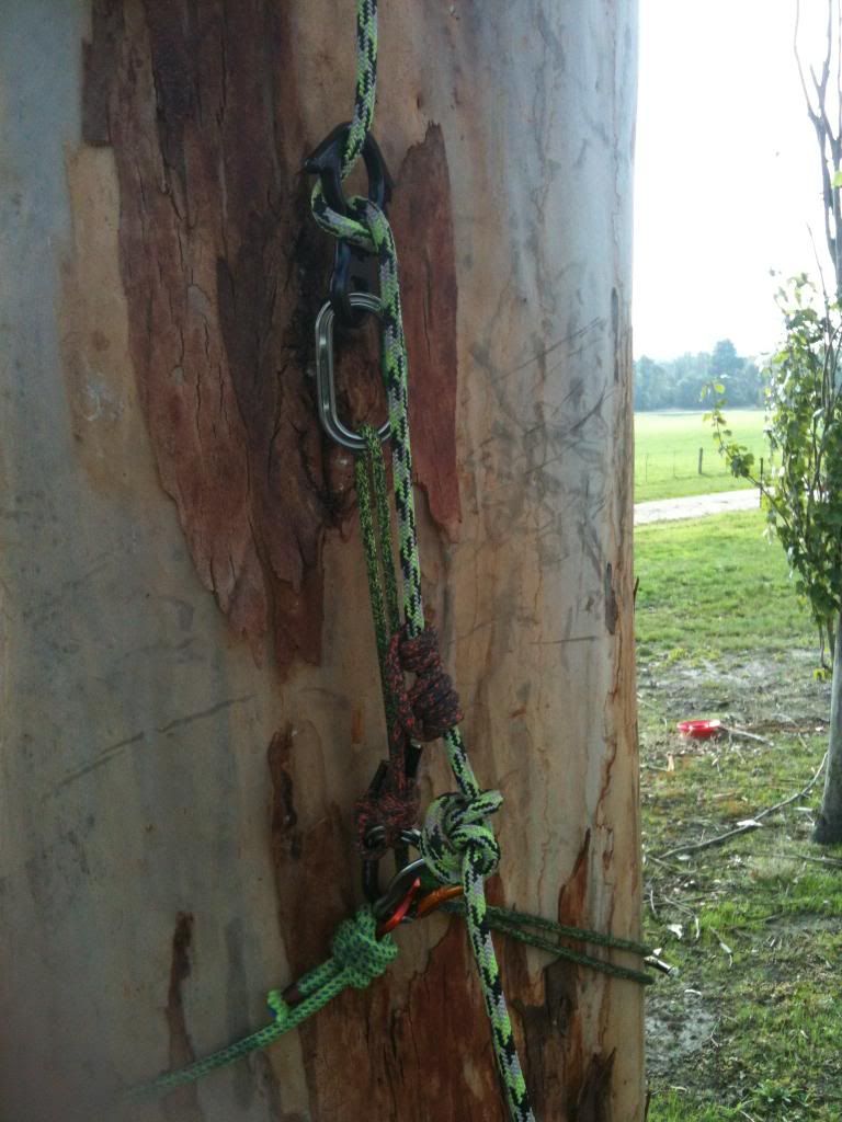

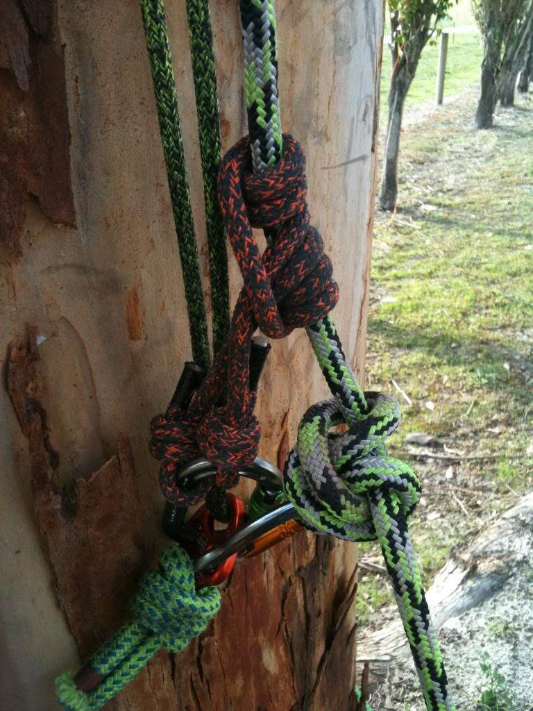

This is what I'm using after I read up on the Gri Gri. Essentially from Donney's SRT manual.
Hi Oceans,
If I understand you your just poking a bite of rope through the 8, hooking the biner through the bite much like what Kevin did with the 8 and revolver before the wrench so as the friction isn't as great as hitching it through and around the 8?
Yup, that's it, Tony. A ring could be used as well (in place of the F8) to create the same effect.
I keep my hitch above the F8, and both the hitch and F8 are on the same leg as to maintain a choke around the base.
My respectful constructive criticism of your base anchor would be to put the hitch (which will hold until loaded to a point of slipping) where the F8 is located, and the F8 below the hitch.
I've looked over the setup, and it seems like if the F8 were to go slack and allow rope to pass through, when reloaded, the hitch wouldn't create the choke effect. Essentially, your choke is created by something that could allow the rope move, and the hitch will release the choke when loaded...
...or am I seeing that totally wrong?
That last picture is pretty much what Oceans is running except he's got a hitchclimber involved. Squirrel, one problem I see with your set-up is that if things do slip your backup knot will get jammed onto the biner and you'll never get it off.
Hey Oceans, never fear to criticize constructively, I enjoy widening my knowledge base and objective opinion is a key element to achieving that.
I am not quite sure about the issues you raise. When I originally went to this setup I tested it by slacking the line and the whole set up "lied over" as one as such to the choke around the barrel, essentially it "flopped". Then returned to its original setting when the line was weighted. I did this a number of times to ensure the components would hold correct orientation and the hitch set (it never unset). I think I understand what your saying and will have a closer inspection and further testing when next setting it up. (This was a quick demo set up just for the pic, and I noticed I didn't girth hitch the choking prussic around the biner connected to the F8 in the pic. My bad)
I agree with Eric, here. Surely, if the hitch is called upon to hold the load it will un-choke the base anchor.
I can see where Oceans is coming from now, its never budged to date. But I am now skeptical of the reliability if loaded heavily. It requires further investigation and scrutiny for sure. I appreciate the candid views.
Tony, can you run both devices through the choke? That's what I've been doing with good results. With everything adjustable, you can tune the 'flop factor' down to zilch.
