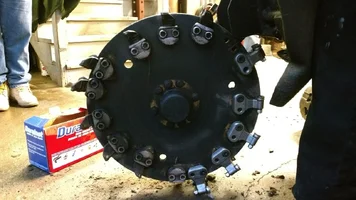

I'm putting new green teeth on vermeer 50tx i acquired today as we run them on the 1635 rayco and love them. I can't get the two pockets in the close position to fit next to each other any advice is appreciated before I reach out to green manufacturing . As well I haven't determined where to place the (2) reverse angle pockets and the (2)straight pockets on the wheel. As the wheel appears to be divided in thirds to me as to there pocket location. I know balance is key to performance and I'm a bit jammed up with this thought.
i think they make a special wheel for this machine to make greenteeth work on it.
