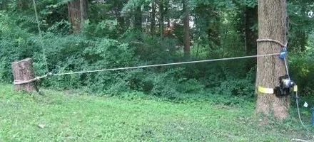

Good to be on opposite side from peices being rigged down for sure. I know not always possible in many landscapes but we always try to get out of the "rigging" as much as possible. See attachment.
Gets the guys away from under the peices being lowered. Expecially on dead trees
I keep the GRCS away for the simple reason that I don't want it to get hit by a falling piece of wood, brush whatever... Sometimes I have the need to let things fly for one reason or another, and if the $2500 device is in the way it kinda cramps my style. I like Matt's idea for sure.
-Tom
This is a great idea. We have been using it whenever we use our GRCS. It also gives the rope man a little better angle many times to see whats going on. The only thing that I do different is, no block over the top. I go in the side fair lead. the pictures is pulling over a spar but its the same theory.
