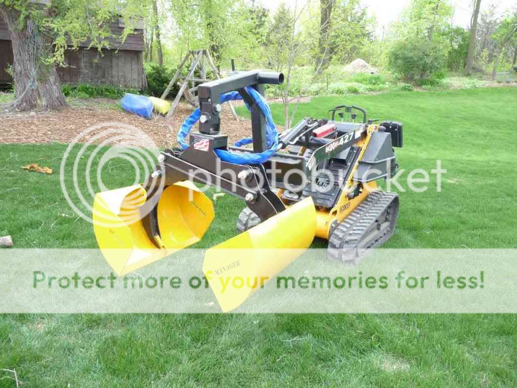

Thoughts . . . A root grapple will excel at cleaning up slash from woods jobs, and a very experienced operator can even cruise it over a lawn without to much damage. Remember with a bucket type grapple every thing comes out wide. You will get very familiar with "cutting it bucket width" This does not lend itself to feeding the chipper very well. It is my strong opinion that a Skid grapple is much more efficient for forwarding tree brush and logs. I have run both type grapples on big and mini machines over my 25 years in the Tree Biz and I would say these things even if I didn't sell BM grapples. As far as slash and manicured lawn cleanups, I suggest you consider this it is totaly new to this industry, see posted pic and the thread "I hate Raking"

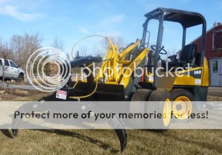

All machines have there pros and cons, In my experience Articulating Machines are the most turf friendly, maneuverable forwarder you can own
This is an example of a top of the line tree guy forwarder loader

Another down side to a bucket style grapple is you have to line the grapple up to the wood. This means extra driving on your clients lawn more wear and tear on your machine or you Doze your wood to line it up with the grapple again more wear and tear on turf and machine.
With a bypass grapple you can approach the load from the shortest access and turn the grapple to the load. Then back straight out, less traveling/turns on your clients lawn and less wear and tear on your machine. This advantage to me outweighed the picking up of rakings. We still tarped them out.
When I got my first bypass grapple I really thought the same thing, that I would miss dozing and picking up the rakings.
but we soon forgot all about doing it that way.
Now for stump chips the scoops work awesome - No dozing on the grass
