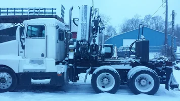

SJ I know you've seen several trucks/ different setups. Do you think on the shorter wheelbase trucks, the added nose length of a conventional truck is more stable than a cabover in a cab mount situation. I finally got a side pic with the boom on. Still have the tank and bed to mount then routing everything. But the pic just shows how short the truck is overall

Oh i forgot to say 13 ft by 8 ft by 4 ft sides dump body , 1999 volvo double frame from the front to the rear, 20,000b front axle, 46,000 lb rears, front stabilizer and rear stabilizers , 31 ft total length. 20 3x6 trac mats mounted between the crane and the dump body, two 18 inch x 18 inch x 4 ft tool boxes and one 18 x 18 x 3 ft tool box, truck weighs 46,800 lb empty, 65,000 GVW .IMG_0051.webp IMG_0031.webpIMG_0035.webp

Yes James because the front axle is that much further away from the crane center. That is short truck ! I can see why the load chart numbers were changed by hiab .

Rick, did you ever find out what weight you are legal for? Here in Minnesota with just 3 axles we can only do 54,000 on a 10 ton route, or 52,000 on normal 9 ton routes. I think my Tree-Mek (when it gets built) will only be legal for 48,000 because of short wheelbase, despite the 3 axles.14570619888861645545133.webp

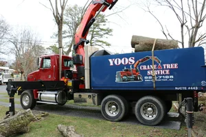

There are many cranes to be had overseas, with that being said you need to look long and hard because their market is so different than ours, most are 24 volt, different radios, these cranes where taken off of a truck for a reason maybe an up grade who knows , you are buying site unseen and once they have your money well . I am not trying to kill Tanners idea but i was going this route and almost got burned, so if you want to go this way do all of your homework .

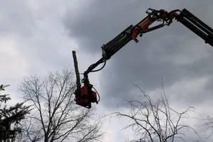

Hey Ben , because of the cold weather the cycle times now are a little slow. When I set up we always try to keep the chip truck or landing zone as close as possible so the cycle time is reduced , in the beginning of the removal cycle time is very slow because you have to cut your way in,once the tree is opened up I can go pretty fast! Knowing the tree species and wood weight will tell you how big of a piece,which also speeds up the cycle time. Time at the controls ( a lot of reps) .

Thanks, Rick. The drywall delivery boom I am renting is sooooo slooooow. The full articulation for the jib/outer boom takes about 17 seconds as engineered. The main is the same, but seems a little quicker. And 24 seconds to make 360 degrees of rotation. That has me thinking about actual cycle times on the crane. Although Jamie Montgomery (I think Tree Mek 4) told me he still has the crane slowed down because it is faster than they want for now. I think he might have the same crane as you do, I know it is bigger than the 33002, plus he has the larger Mecanil head.
If I remember correctly the next two crane sizes above mine did not offer endless rotation that is why i chose the 40002 for that feature, some of my function speeds are turned down, now after 6 months of use i find myself advancing the idle speed because they seem slow to me. The SG 220 will cut 18 inch wood , the SG280 will cut 24 inch if Jamie has the SG 280 on the pk40002 thats a big cut for size crane. I see going bigger but over the life of the crane bigger puts much more stress, believe me with the SG 220 you can go way bigger than the crane can handle ! I didn't want to be tempted by the larger cutting capacity .
