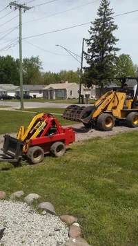

I'll 3rd that Lol. I sold my swinger since i got the treemek. Was to impractical in tight city work. My mini goes to work every day. Now id like to buy a 2nd to have 2 on the job site.20170509_134750.webp
I'll 3rd that Lol. I sold my swinger since i got the treemek. Was to impractical in tight city work. My mini goes to work every day. Now id like to buy a 2nd to have 2 on the job site.View attachment 51440
I can understand that for tight city work, however, most of the work we do is not in very tight yards. I almost never have a problem accessing with my tractor that is 6 feet wide. What were the specs on your swinger? Specifically how wide was it and how much was it tipping capacity?
