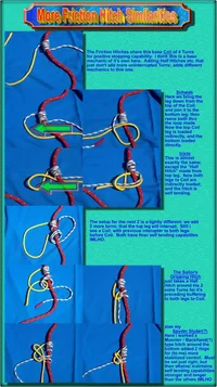

i prefer Tenex. Lays flat to be leveraged less by both factors of flexibility and size of bent dimension. Also for it's rated 'diameter' gives a larger footprint of grab on the host line than some larger 'cords'/tails. My favorite lifeline/ friction hitch (shown last) works much better in this flat device/cord than round cord (as well as Icicle, Sailor's Gripping Hitch IMLHO).
i see a doubled over coil in Klem, but not Icicle??
My Slyder is mostly only tested by my flyweight(for a few years); but follows the same form as the rest. Please all ways be care full!
