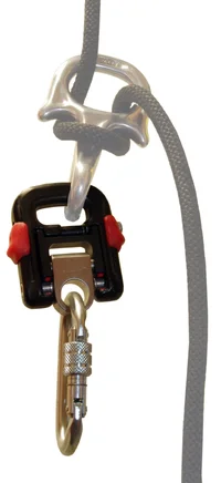

If your doing some bits for a SWAT team, try and source some Qiuck Out karabiners - they are great for getting out of rappel quipment in a hurry as you can release them under a full load.
Best place to find them is at paragliding websites (if you were in the UK I could get you some ;))
