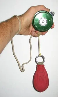

Here's a pic of my whole kit. Everything goes into the New Tribe line mug. The reel has a lanyard made from parachute cord. There's a running bowline that chokes around my wrist. This eliminates the Fumblies and there are times when I need both hands. I'm going to get another smaller bag like a Harrison Rocket. The NT Grappel is in the bag too.

The leash is choked on my wrist. I pay out as much line as I need. Then when I'm done the chrome tab is pushed and the line is reeled back inside.

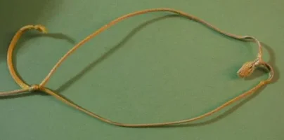

The line is Specra that Sherrill [used to ???] sell. It's like big dental floss. The line is very slippery. In order to make a loop to tie on the line I had to use a figure eight on a bite and set it with two pliers. In order to get the line off the ring of the throw bag I tied another figure eight with a mouse ear-sized bite. That makes a little tab that I can pull to invert the choke.
