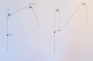

Do you think the FL helps significantly over this idea, using one ring/ screwlink/ connector?
With the Flint Locker, as you retrieve your line, the friction saver can float somewhere between the blocking knot and the TIP. I assume it would be wherever the resistance is least, depending on where the first redirect point is in relation to the TIP. With your method, or the one in the video, the friction saver is forced to come down with the knot, increasing the bend radius and friction on both the working end ring and on the redirect limb, until the working end is free from the first redirect (or any other limbs it might hang on during retrieval).
Yea, I use an ISC wizard with a rated gate, and clip an alpine butterfly. I agree that it seems to accomplish the same effect. I still don't see how any of these are beneficial for redirected retrieval. How is any of this better than the rope just hanging through branch unions at modest angles? The issue for me thus far is that the bend in the rope gets sharper as the ring/biner/FL gets pulled away from where it was anchored. So far, if I do re-anchor like that, I will be returning to undo that before descent. I have given up up redirected retrieval, as it seems to take more effort to pull the rope out of that mess than to climb back to the TIP and descend.
