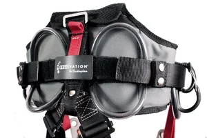

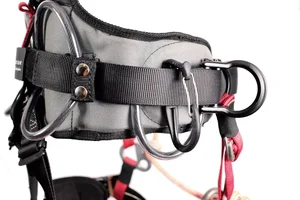

I'd like to see a photo of the back. I'd like to see how to store tools.
Here it is
Also the back is an open web construction so you can customize and place beiners or caritools where ever you want

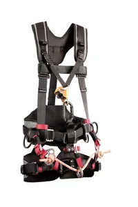

Ok here they are
1) Fall Arrest attachment
wow, now im fully impressed, ill be placing an order tomorrow after work, good thing i have some side jobs lined up to pay for it.
