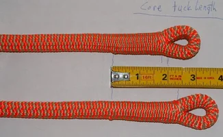

Here are my second and third splicing attempts on Yale rope. It is interesting to see how much the throat shortens up [and gets a lot fatter] on the final bury. These came out better.
Also, I still think it was a lot more work to splice the Yale rope versus Samson.
Thanks guys.
-Michael

I'm thinking I like the looks of the lower one, at 2.5". I'd be curious to know where those break. Still seems a bit short for a 7/16" Class 1 DB, but that's just going by my fid lengths. My long fid is about 5.75"
Jontree, that length is from the manual I learned from...New England Ropes Splicing Guide. It's available online, and covers most all styles, including FLY...which is ugly as heck, but still works.
I did the second one a bit short of the short fid length.
On the third splice (2 splice in the last photo), I measured out exactly one short fid (on my aluminum fid) which measures 3 9/16". However, you must remember that the rope shortens up a lot when you finish the final bury. I measure the diameter of the throat to be 3/4" at the fattest point (versus just over 1/2").
I did a forth splice and this too came out to 2 1/2". Man was this tight and took a LOT of work to close the eye up. This was the other end of a 6 1/2' rope and there was no slack left in the rope when I finished. The eye was slightly larger.
-Michael

Samson instructions call for a short fid length to bury the core. Are you sure it doesn't say 1/3 fid ? I would be amazed if you could finish the splice with a 2/3 fid core bury on this Yale rope.

They split the difference and have you bury the core ½ a fid. I typically do 14 rope diameters (aka long fid aka ⅔ fid) but then I do a longer, smoother taper which yields a smoother finished products and takes some of the pain out of the final running home.
