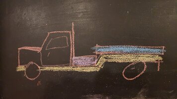

Obviously table height would be variable based on the truck used. I've pictured something like an Isuzu NPR that seems to sit pretty low to the ground.

I delivered lumber for a company that ordered f550s on double cab chassis with only a single cab. That makes a space for a 4x8 foot lower deck height they used for transporting sheets of plywood.
Could be even more low space if ya slapped a cab over on a xcab chassis?

My mind’s eye is having a tough time with your description, though I think I get the gist. Is this a space for a few sheets where the frame rails dip down but the subframe and deck run straight from the height of the frame over the rear axle? Jeesh, just reading my own sentence hardly makes sense…
If I’m way off base, can you post a photo or drawing?
So would a chipper fit in the purple?
