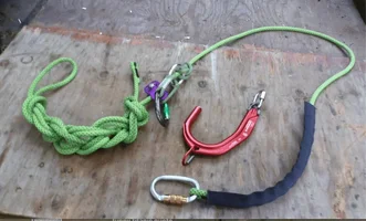

Here are some photos of my 25 foot lanyard I sometimes use SRS as a short climbing line, with the new Sticht Hitch on it today. Two of the photos show my modded hand ascender with a pulley for adding some MA if I need it when working my way up a tree or swinging sideways. I got the idea of double daisy chaining the long lanyard from one of AJ's posts I think.
View attachment 59513View attachment 59514View attachment 59515View attachment 59516
Looks nice. So you basically built your own CT quickroll.
Your hitch is more of a Distel Sticht, or a Stichted Distel, the original being only wraps/ round turns. Also the ring might be too large and allow slack from the wraps to transfer to the legs, making them longer, with extended use.
