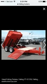

I know I'm like a broken record with this, but this is the style I'd be looking at if I wanted to haul a mini and a grinder. I'd get it longer, and with two rams, and taller sides, but having that deck for the mini is key.

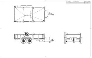

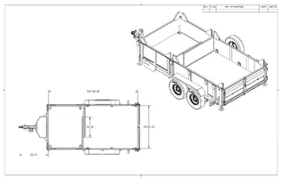

Another idea is instead of a platform trailer, you could have a regular dump trailer with the front of the trailer's walls removable and installable as a headboard. The downside is you can't dump with the machine in the trailer (well... maybe). The advantage is more capacity when you need it.
Screen Shot 2016-06-30 at 7.30.25 PM.webp Screen Shot 2016-06-30 at 7.30.19 PM.webp
Hey, I recognize those drawings Carl. :) Carl is having that trailer built for me.
Avant will load across the front when I want to haul it there, with a smaller load of logs in the back. When I want full trailer capacity for wood, I'll have that.
