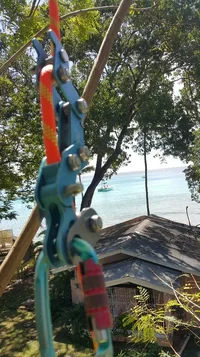

Even my son Sam at 7 knows what's up. Here he is running a wrench. Ct footie and saka mini with a chestie. All dialed in by me. Does over 50' easy peasy.View attachment 56936
Swingdude, do you run that poison ivy line SRT like that all the time? I'd think it'd get a bit bouncy and annoying...Maybe i'm wrong, idk, I've never tried using that line for SRT, how do you like it in that config?
I bought some Poison Ivy some months ago precisely because it was less bouncy SRT than the Tachyon Ash I was using. I like a little bounce so the Ash felt OK on a shorter ascent but for a long one it was just too much. The Poison Ivy seems much better (RW/ZZ or BDB). Also it is less obvious at a distance if I am rec climbing and don't want to be hassled.
I was harassed for years because I liked Tachyon lines for SRT ;-) Now when I reach for a rope bag it's going to be a Yale 11.7mm double braid (whatever color flavor of Poison Ivy it happens to be). It's the best line I've used with the Rope Runner, no slouch with Rope Wrench either. And you can can tie up a Blake's on the tail if you're feeling nostalgic for DdRT, Yale 11.7 mm lines work well for any tree climbing system you can come up with.
