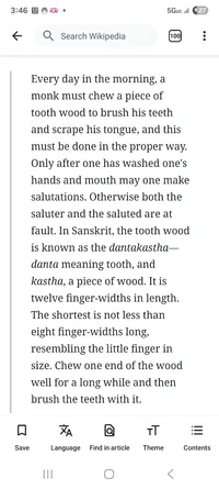

Of all the things I've learned on treebuzz, brushing my tongue might be the most life changing. I've been doing it for a few years maybe after reading a post from you treebing. I've literally only been sick one time since then and that was covid. Absolutely essential
No my tongue does not get scraped. I had no idea it was a thing tbh.

Sticks and grass can also be effective at cleaning teeth and they definitly are cheaper and no multi national corporations involved. I DO find it far more interesting that people dont find it necessary to clean their tongues than I am of people using natural crotch rigging. I cant help but wonder watching this video if English are unaware of their reputation as having the worst teeth in the world. That to me is what makes the video funny.
