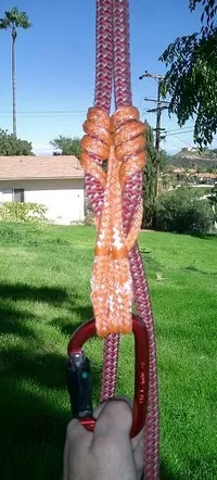

There are a ton of ways to do this back up. Here's mine...

I use a petzl chest ascender under the double ascender attached to the tether with rated screw links. That is the back up for single line... For double line I back up the second line with my regular climbing hitch and biners, keeping the hitch above the ascenders and clipping the biner through one of the handles... The Kong advances the friction hitch with negligible added friction. Everything just snaps in place then unsnaps, and the climbing hitch is right where it is needed to get to work... no fuss, no extra gear..
This is well within my own personal safety margins, though technically, the manufacturer, Kong, does not approve of clipping the biner through a handle, so I've been told the system couldn't be used at a strict TCC... Guess I'll have to make it to the Masters Challenge one of these years to find out for sure...
