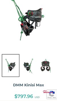

Attention Shoppers: It's 24-Jun-2024 and Maple Leaf Ropes has the Kinisi Max on their website for ~ $875.00 Highly Devalued Paltry Northern Canadian Pretend Dollars. Great price and not only that, the Vaults and other bits and pieces are on Sale too! Sale is advertised until June 29, 2024 so if you're in the market anyway . . . . Cheers all and stay safe out there
Addenda: I'm in no way affiliated with the vendor or get discounts or anything but just thought a heads up would be nice, for someone that may have missed this and be in the market anyway.
