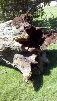

I just took down two cherry trees, each had over 90% decay in the main stems.. they weren't dead, but with the amount of decay it was amazing that both were still standing.. Nice to be able to work those out of the bucket..
and the other tree.. cut was about 15' height..
surprised me to see this one so hollow.. lot of weight in the top of this tree too.. Had 3 triangulated cables which no doubt gave it a lot more stability...
