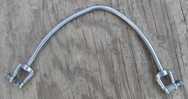

Finally...I got a picture of the cut resistant bridge that I made for my Butterfly II harness.
The rod is stainless steel. The eyes are from a swivel shackle. It took some time to bend, tap and thread the pieces.
What I found was that the bridge worked wonderfully! It acted like the old spreader snap for the four dee saddles. It kept the harness from hip pinching when I rolled to one side or the other.
After using the bridge for a while I found that the rod would get a bend at the 12 o'clock position. I talked with a friend who is a knowledgeable machinist...who gave me the rod in the first place...about the bending. He told me that I could find a more springy rod rather than the flexible stuff that I had. I never do go further with the concept
I don't think that there would be a more cut resistant bridge than this one.

that's quite a bridge, tom. did it affect your ability to attain certain positions involving leg spreads and such?
There were no restrictions. By having the support up instead of in, towards the V the support stayed out on my hips.
Shortly after I fab'd this the TreeFlex came out and solved the hip pinching nicely.
