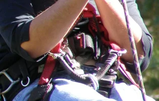

I have a master deluxe and I made my bridge form a short a bit or ultra tech. I used two BFII clevis to attach it all to the saddle. I did have to play with it a bit to find the right spot but once I did I really like it.
Jared
I went ahead and bought the BFII shackles and short BFII bridge from sherrill, so I could be confident that it all met the weight requirements. I love my set up. Here is a picture.
I have been thinking about doing the same thing. I'll have to give it a try now.
