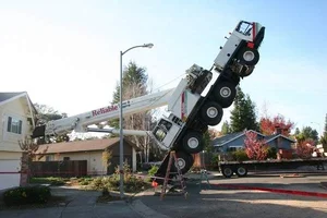

Unless the notes in the load chart say otherwise you should setup with the tires just off the ground, the axles and tires are calculated into the load chart as counterweight.
As far as the CofG question is concerned as long as the CofG is some where on the opposite side of the outriggers to the load then your rig will stay dirty side down, its when it moves to the same side that you will have a problem.

Staying in the charts (load chart as related to the green log weight chart) is somewhat science in the former and debatable in the latter chart. Very hard to accurately weigh some picks in your head esp. given foliage weight.
Then enter shock load which some say figured into the large Cali tipover. The C of G can veer suddenly off the chart with shock load. Experience and insight and intelligence are so important related to this instance.

You just have to be more careful cribbed up like that. If it falls off it won't be pretty. Back in 1980 when I first started renting out cranes and nobody else was using cranes for takedowns, I slid a 19 tonner boomed out 80 feet over the back 30 feet down a steep concrete driveway and almost got to the primaries.
No harm done and even the scratches on the drive were minimal. After that sometimes I took to attaching a dump truck to the cranes on the uphill side with chains.
Few years ago a sub I use had a 30 ton boomed out over a hundred and twenty foot oak and he couldn't see me very well and I thought I got the nod. He was cribbed up like that and I let her fly and it gave some shock load on the butt and he told me he saw his life pass in front of his eyes. We got a laugh out of it afterwards.
It is great to have forums and threads like this for learning. I feel I started in the wild west days. I invented everything I did and improvised as I went along. It was a scary job sometimes, esp storm stuff.
Sliding cranes are always a good time. I was setting up a GMK3055 one day on a slight grade, a salesmen had insisted try out a set of DICA pads,. The outrigger controls are on the side of the crane. I was on the down side of the crane and had just gotten the tires off the ground when the whole crane side towards me... never used them again. I have had similar experiences with alturna mats.
