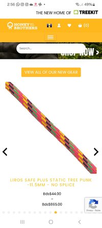

I am doubtful Courant can make a proper static rope with all the CE bullshit. Now this rope is static. Have 3 hanks I like it so much. Great on your hands, knots well, wears well, loves wrench and runners. Ticks my boxes. Screenshot_20240101_145633_Samsung Internet.jpg20240101_145924.jpg
I am doubtful Courant can make a proper static rope with all the CE bullshit. Now this rope is static. Have 3 hanks I like it so much. Great on your hands, knots well, wears well, loves wrench and runners. Ticks my boxes. View attachment 91912
I think wesspur sells this as drayer statx. I have some, it’s stated as 11.5 but really more like 11.8, and yes that stuff I think is the most static on the market at 1.2% elongation for a climbing line.
