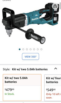

No I have Milwaukee stuff now, I started with Makita but it was kind of a bad Era for their battery's and they kept crapping out on me, I think they fixed the issue though.Anyone have experience with this Makita? Im looking into it for bracing.
https://www.amazon.com/Makita-XAD03...ocphy=9014893&hvtargid=pla-572274713697&psc=1
