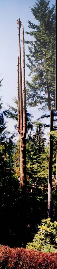

I do most of my removals spurless with a mix of top down and bottom up. I get a line into the tree and go SRT for the top and get tied in. I then strip out all of the stuff I can cut and toss without creating a bunch of hangers and if neccessary set a block for the lowering line. Doing conifers without spurs, even large fir trees has made me faster not slower and a much better climber. One trick so the rope doesn't hang in the way of falling limbs or the ground crew is to get tied in at the top and stuff your rope into your rope bag and keep it clipped on your saddle. I use a Mountain Tools Feed Bag http://www.mtntools.com/cat/rclimb/rope/mt_feedbag.html clipped to my harness. It is really nice and compact and holds a 150' climbing line just perfect. Just make sure to put a stopper knot in the end of the rope so it doesn't just pop out of the bag and right through your hitch.

Actually, I limbed it on the ascent, but at one time I climbed to the top to to descend and drop some weight off one side so I wouldn't have to use a rope. Or wedge.
