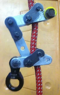

When I was at Expo I picked up a Rock Exotica Micro Swivel. This afternoon I mounted it but I haven't climbed on it yet.
Eric/Oceans had some input which has merit. He would clip in with a biner and have the swivel, with a larger eye, floating on the bridge. He likes the action and can use the eye to clip in a second system too.
For now, I'm going to put it on my bridge just like I've run the Unicender for many years. If I use a second attachment I use the ring on my bridge or clip directly to the bridge. It all depends on which way I want my multicender to faceCR BDB with Rock Exotica Swivel.webp
Definitely looks cool ..function of the bone in my experience with it, is a redirectors dream ..if you are planning on leaving it on bridge simple redirect s where you could pass the bone around by just uncliping without taking rope out of bone would take a bit more time,I'm talking a few seconds in reality ,that's the only limitation I can see , but if it not an issue to you TD rock on !
I think the cool thing about it is ...we want bone, swivel, biner. But this setup takes a piece out of the bone and replaces it with the swivel. So now we're back to just bone and biner, yet the bone still swivels. I like it.
I didn't measure the ID of the swivel eye before mounting it. That's probably on the Rock Exotica spec sheet. There is a little play. I might find a bit of tubing to sleeve the pin.

TL...I don't like the term 'ghetto lookin'
Using things for a second or third purpose fits with my outlook. Save resources...be creative. This is an evolving process. Since I had the plastic washers I used them. much easier to modify plastic than to modify a stack of metal washers. If things turn out right I'll have a much nicer finish. I think that using large diameter socket head cap screws would be ideal. I have some that would be the right diameter. The catch is that I'd have to drill and tap the holes bigger. Since I only need a little thread I'll have to cut off the screw to fit. Way too much work for my first itteration.
If I were to eye-ball estimate the ID of the small end of the swivel I'm guessing that I only need about 3/32" shim stock. The rubber insert is meant to grab an oval cross section biner...like a Rock O ;)

That looks real nice, Tom. I was planning to do the same thing but decided to hold off for the time being until I got to know the BDB a little better. One thing people should be aware of is that when you capture an eye of a small swivel like that on something as long as the Bone, the risk of side loading the swivel increases. Mounted on your bridge the way you are planning to I can't see much danger but if it were to be used in say a DRT setup the chances for cross or side loading would increase.
I'm not sure I comprehend this completely sir , care to elaborate if possible?
Just kidding with ya Tommy D. Nothin wrong with it. Just thought you could 'bling' it up a little. :)
"TL...I don't like the term 'ghetto lookin'.." You gotta be kidding me though right?
