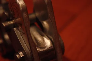

i am on the 13 mm kmIII as well, and I filed out the very bottom of the spine to allow more room for rope gobbling. Not on the flat of the spine where it grabs when engaged, but at the point where it curves under the flat. Where it contacts when disengaged.
