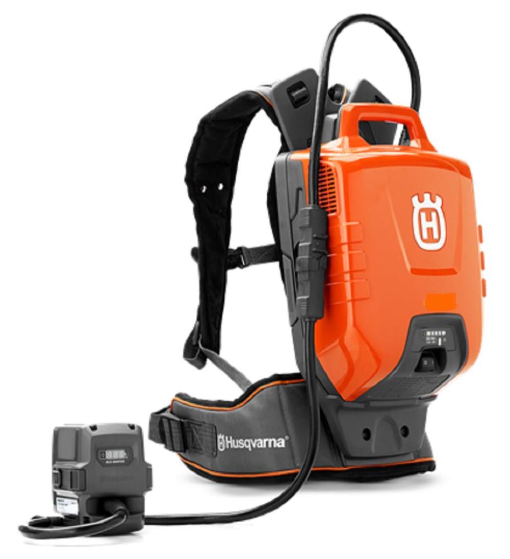

For top handle battery saws, I wonder if any manufacturers have considered making the battery separate from the saw connected with a cord/lanyard combination (that would of course need a breakaway/unplug feature.) The saw could be very light and still have ample amp-hours.
That's not quite what I had in mind. It weighs in at almost 21 pounds and you will have both a cord and a lanyard. Except, I wouldn't need the lanyard because I'd be limited to working on the ground, since the battery harness looks incompatible with using a saddle and the weight on my back would have me inverting all the time.
With that large of a battery, I imagine you'll run out of oil long before you exhaust the battery. (But I guess you can just strap a jug of b&c oil to the battery!)
