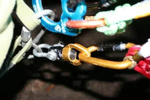

...Sorry for a slight error/confussion. The Swivel I use for climbing is actually the Petzl® Anchor Swivel, pictured in my attachment.

I got this recently from Ax-Man. It is the Petzl swivel and I am using it to keep things straight at my lower connection point. Seems to do a very good job so far.
