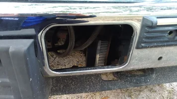

#2: If it is 1993 or earlier it has no PMD for the injection pump. If 93 or later, move the PMD from under the hood to the grille or I bolted mine to the frame right in the air scoop in the bumper.
