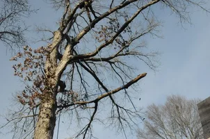

Hey, welcome.
I'm not reading the other posts. (maybe another day)
I looked at your picture and this is my immediate reaction.
wow, you need more butt weight if you tryig to balance that, and I know it's hard as a climber, but if you can't see that from the picture, I hope you can see that soon.
here is about the proper butt weight to balance.
picture:
But, at that angle, dangerous!!! That butt is going to come at the climber like a an army trying to break down a castle wall with a large log!
holy crap!
The upper diameters look large in that tree, like where u are tied in.
why not have a higher rigging point, tip tie and crank a third of that limb up at a time?
I almost NEVER spider leg limbs in rigging with a lowering device. crank them up, or let them hinge down.
spider legs are best for crane picks, imo.

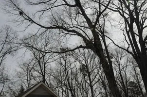

X2 on X's Post. (like the poetic symmetry there!? Totally intentional!!)
Also, seems as if a redirect would have helped spread the forces, clear the roof line and lessen the chance of swing into the climber.

Hey Xman, I had the same thought you had after reviewing the pictures. I should have cut a little further down the branch in order to balance it properly. To me it is kind of like reviewing a football play.
Tip tying only would have sent the butt end into the roof. However the idea Chris had would have kept the butt end from dropping to far.
I love the way white oak hinges. The branch swung clear of the roof before the hinge broke off. I used a long notch cut to make sure of that.
