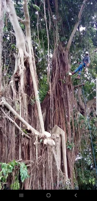

Ok. Here at my son's school play. There is the rubber tree here. Looked at two cuts. The callous around the cuts is lame. But I think it is a variety thing. Some do well ithers not.15762741470187397259660641030614.webp
