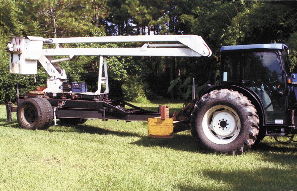

Would this be a bucket truck or a mobile lift?
It'd fit in the category of a lift but more like a nifty lift pull behind. Neat that it's hydraulic powered from the PTO. I've seen a couple of those around.
