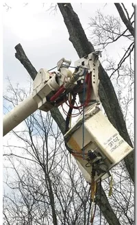

This accident happened a few weeks ago. The climber is still in intensive care unit.

Looking closely at the pic I have a few questions. First, the blue rope has nothing on the end. Isn't it normal to have at least a snap or something on it?
I wonder if maybe he was lowering something and the rope broke (although the end of the rope doesn't look particularly frayed). The boom could have then suddenly jumped upward causing the bucket to strike part of the tree with a severe enough blow to break it. Another possibility could be that the rope-breaking scenario occurred and the operator was thrown out as a result, his fall protection was attached to/near the operating control, and when it "deployed" (reached full extension) arresting his fall, the shock was too much for the already (previously?) weakened bucket, causing it to fail. The bucket is marked as having a capacity of 275 lb. That could easily be surpassed by a fall arrest system, couldn't it? When it failed, the fall arrest, having already stretched to its max then failed with the second loading produced by him falling another 6 feet.
Not to say that he was necessarily doing anything stupid this time...
Is that a wrap of duct tape around the base of the bucket?
I'm wondering why he put pressure on the bucket at all. Need more info to be sure. If he had a full fall arrest harness and lanyard attached to the boom he might've been ok.
I never see too much use for material handling buckets myself only because in the hands of the wrong people they will try to lift way more than what they can handle. The ex-Davey guys I worked with would use 55ft high ranger forestry booms as modified "cranes" to lift wood over fences. No wonder that particular bucket had three longitudial cracks in the boom and had to be scraped.

I can't visualize how the thing would go back together. Which is another way of saying I can't see how \the bomm/bucket looked before everything fell apart. The 'blue rope' appears to be run through a pulley and some other bracket at the end of the boom. If I try to visualize the bucket back on the end of the boom it seems that the pulley wouild be in the middle of the operator's part of the bucket.

I pplayed around with cropping and enlarging the original picture. It looks like there is duct tape around the base of the bucket. Look at the yellow strapping that's hanging down from the bucket. That looks like a ratchet strap. Could the bucket have been cracked before and someone used tape and strapping to hold it together?
The blue rope is run through the sheave at the end of the boom. I can't see any attachment of the rope to the bucket.

That's a rope winch assembly on the top/end of the boom. The bucket mounts to the side. Note the text which says "pushing on a limb" was speculation on the part of the emergency responders, and I believe the phrase "the bucket lift ... broke down the middle" would be better as "the lift bucket ... broke". From the photo it's obvious it didn't break "down the middle" so this should provide a clue to the ability of the responders to have a clue.
I also see some tape around the base of the controller. It definitely appears to be a strap connected to the controller mount. I'm thinking either it was his fall arrest and/or that the rope winch wasn't working to his satisfaction and he had a load attached there. I guess it could also be that the bucket had been obviously cracked and that the yellow strap(s) hanging were there to cinch up the bucket. See the enlarged section attached. Note also that the bucket corner on the left in the picture is also split from top to bottom; the corner on the right is the only one still intact. Hmm...

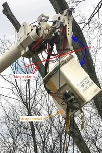

Try this as attached.
