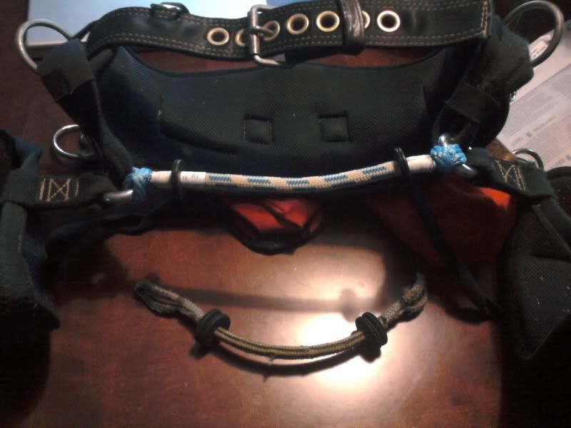

just replaced my cougar rope bridge with a glide. glad to be done with the cougar rope bridge and any thoughts that occur regarding it when I'm in a tree!
I just replaced my stock bridge, it was showing some signs of wear, climbed on it for 2 years. (I should have earlier)
Got the Warp Speed glide bridge, ordered from Treestuff on Monday, just got her installed. 50$ is nothing, when you look at the value of your life.
I trust my belt 100% again. Isn't it pretty much a Viking belt now?
Not the viking, the Puma! LOL, jk same saddle haha. $50 is nothing. You have people climbing in $600 spikes to be comfortable but wont bite the bullet and replace their bridge every year.
