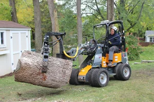

How do the three teeth at the ends of the new BMG work for holding onto big pumkin log pieces when you grab rounded sides?
Or rounds that are so heavy you can only cut them 16" long and grab the flat sides???
And....are the three teeth at the end of BMG jaws in the picture standard production now or just an experiment?
Thank you.
Thank you.
@Merle Nelson

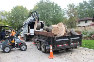

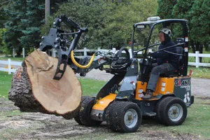

They are in standard production! The teeth themselves help a bit to just dig into oversized wood and keep a firm grip on it. What is probably the largest help is a check cylinder. No more bumping your hydraulics to maintain grip.
Currently it's offered as an upgrade option, also as a drop in replacement for your current model.
Pictures attached of pinching a cookie. That grapple actually didn't have the teeth and was an early check cylinder prototype.

@Merle Nelson
View attachment 65588View attachment 65589View attachment 65591View attachment 65590
Here's a video from that photoshoot showing off our T1001 BMG
Thanks,
-Blake
