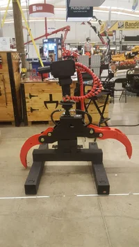

There's three of us that locally that have torn up the jaws on bmg. I know we tore mine up just grabbing brush and logs. I can't say for the other guys. I made all of us some super heavy duty jaws with teeth and they have held up great since then. I really do like the BMG and understand tree folks are rough on stuff.

Here's a couple of pictures. They work better than smooth jaws to keep stuff from slipping out when it's small enough you don't really have it clamped tight. Stuff still slips at times but it's better. Larger stuff doesn't seem to make a lot of difference unless it's a really weird shaped piece. They are also built out of thicker plate and have more reinforcements. I made the ones in these pictures in 2016. I have made more since for myself and some friends. I have a cnc plasma table in our shop that I cut all the pieces on.

@Fivepoints that's awesome! I actually have a picture saved of that arm that I saw another forum from years ago! Cool to see them painted & on the grapple. Loving the red. Looks like you need some red spiral wrap for your hoses to match those arms, we'll get some going your way :)
We've thrown around the idea a bit of adding teeth and ended up with a few sharp teeth towards the tips of the arms- very popular request- picture attached. Dave & I didn't think about rounded teeth/nubs going that far though. Hmm... Wondering if it'll work ok with the BMG Rake. Great ideas.
In the last year and a half we've made a good handful of changes to the original BMG to beef it up a bit, thicker steel, more reinforcements on the arms, grease fitting locations, tolerances, Grade 8 bolt pins, no more flexlock & jam nut on the center bolt... All backwards compatible.
Love all the BMG ideas & modifications I've seen online, talked about in person at shows and hey maybe we'll integrate them like the receiver hitch, bollards, scabbards, pusher etc :)

I've made two sets of the arms like shown above. I made a plain set as well. The guy that has the plain set bought one of the very first bmg. He's used it so much he has wore out the hanger that has the two bolts perpendicular. We made him another one with bushings in it this time around. His was so early it was just a drilled piece of square tubing. His didn't have any teeth on the mounting plate itself either. Nothing to heal a log up to.
We also put spikes on the front of the top horizontal tube to help push logs into the truck. It looks like you guys have really incorporated that well into the bracket that hangs the grapple, now. That's great as it makes it much more useful loading into a truck.
A rake is on my wishlist. On of the other local guys has one. We work together sometimes. I keep meaning to try the rake with my toothed jaws. I'll let you know when I do.
